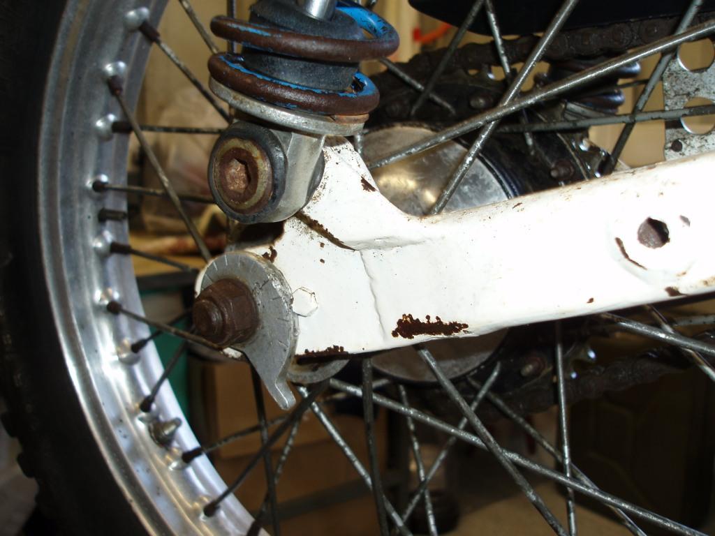

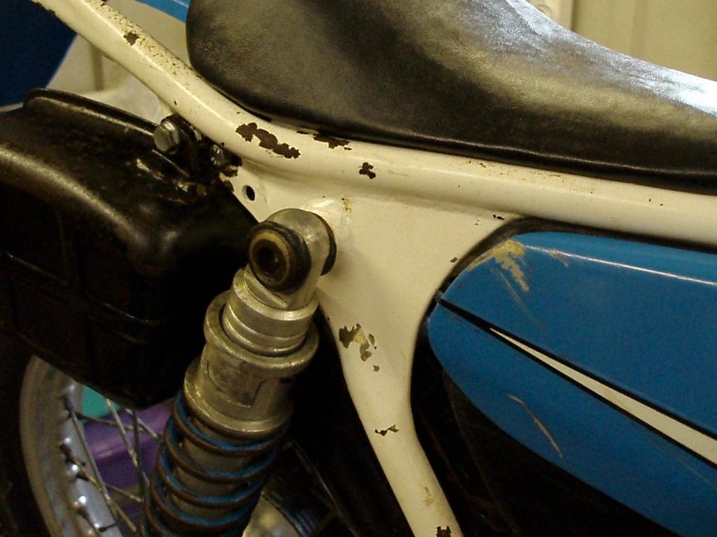

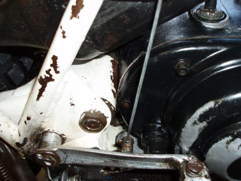

diggler Posted April 12, 2006 Report Share Posted April 12, 2006 A couple of close ups for you Quote Link to comment Share on other sites More sharing options...
diggler Posted April 12, 2006 Report Share Posted April 12, 2006 And another close up. The bike is definatly not one of the comerfords 40 as verified by Dave Renham. But the frame number is very close to the modified bikes, so he is not ruling out the posibility that it was a bike modified by reg around that time ! i.e. untill he discovers evidence disproving this, he will not rule out the posibility of it being some form of comerfords bike, there must have been some 'experimental' bikes before the 40 replica's were produced ?. It may be a while before any proof surfaces as i am sure Dave has better things to do with his time than trawl through old pictures and documents for me. whatever it is, I am well pleased with it !!! Quote Link to comment Share on other sites More sharing options...
trialsrfun Posted April 12, 2006 Report Share Posted April 12, 2006 Interesting topic, on the bikes with the modifications was the wheelbase shorter or was the swing arm lengthened to return the w/base back to that of the std. bike. Was anything changed at the front end head angle etc ? Quote Link to comment Share on other sites More sharing options...
nigel dabster Posted April 12, 2006 Report Share Posted April 12, 2006 Looks standard s/a modified. Wheel base the same head angle unchanged as ithe front down tube hits the front stay as is. Quote Link to comment Share on other sites More sharing options...
