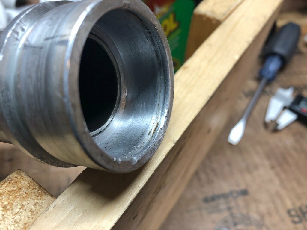

mcman56 Posted yesterday at 03:53 PM Report Share Posted yesterday at 03:53 PM With light oil and teflon coated bushes in the lower legs, I find the stock TY175 forks to work pretty well. Quote Link to comment Share on other sites More sharing options...
lemur Posted 10 hours ago Report Share Posted 10 hours ago 20 hours ago, mcman56 said: With light oil and teflon coated bushes in the lower legs, I find the stock TY175 forks to work pretty well. If only classic TY had teflon coated bushings in the lower legs to replace, but sadly they do not. Quote Link to comment Share on other sites More sharing options...
mcman56 Posted 8 hours ago Report Share Posted 8 hours ago The lower legs can be modified to accept standard size bushings. Quote Link to comment Share on other sites More sharing options...
