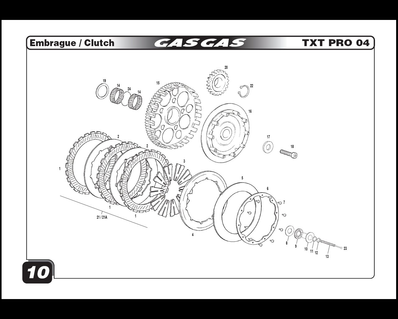

lewis_gasgas Posted April 11, 2006 Author Report Share Posted April 11, 2006 Cheers Rhaines il have more word when i get the bike out on fri or sat and have a look . Do you have to rip it right out to check the plates ? Is there no diagram ? Quote Link to comment Share on other sites More sharing options...
wiltshire_boy Posted April 12, 2006 Report Share Posted April 12, 2006 Lew, I'll be changing mine very soon so i'll try and take some piccys if that will help. Quote Link to comment Share on other sites More sharing options...
ikb Posted April 12, 2006 Report Share Posted April 12, 2006 Its easy to take apart lay the bike on its side (no need to drain oil), Remove kickstart take out the 3 water pump screws pull out the pump and tie back out of the way whith a bit of string (no need to drain water) remove the rest of the screws, remember where they go as they are different lengths. Lift off the casing trying not to damage the gasket wach out for the washer that goes on the kick start shaft and the clutch bearing as they will fall off!! To take out the plates remove the 10 screws with a good 7mm ring spanner then you can lift off the cover plate spring plate and pressure plate. Lift the fingers out note which way up they are so you can put them back in the same way up. Now you can lift out the plate pack. And as they say in the Haynes manuals reasembly is the reverse.... Just be careful to line up the water pump drive with the slot in the crank when you push the pump back in. The parts book from gasgasmotos.es shows some pictures and read the article on the news page on gasgasuk.com as well. Quote Link to comment Share on other sites More sharing options...
rhaines Posted April 12, 2006 Report Share Posted April 12, 2006 Cheers Rhaines il have more word when i get the bike out on fri or sat and have a look . Do you have to rip it right out to check the plates ? Is there no diagram ? <{POST_SNAPBACK}> Yes Lew, you have to take it out completely to get to the clutch. What I would add is that if your bike is newer pro(04/05/06) the 10 screws in the clutch pack are different than the old type which you need a special tool from gasgas (its a torx socket rather than an allen key). I would remove the centre recesed screw from the clutch basket and take out the basket and plates in one piece just incase you drop any parts into the transmission as they have a nasty tendancy to dissapear!!. You can then strip the clutch on a work bench which is a lot easier. Dont worry about taking it apart as you will find is quite easy and self explanitory once you get the clutch cover off...and remember about the clutch cover screws as they are different sizes and they HAVE to go back in the correct way.I will try and get a diagram for you to make it clearer. Quote Link to comment Share on other sites More sharing options...
wiltshire_boy Posted April 12, 2006 Report Share Posted April 12, 2006 Quote Link to comment Share on other sites More sharing options...

lewis_gasgas Posted April 13, 2006 Author Report Share Posted April 13, 2006 Got an Email of Kev Hipwell at gas gas anyway and hes basically said what you have about the middle plates going fat and to just replace them with thinner ones to make up the right length. Quote Link to comment Share on other sites More sharing options...
