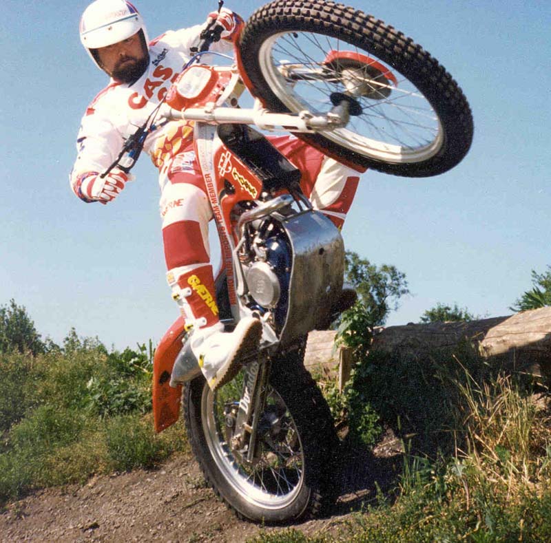

magicmat Posted May 2, 2006 Report Share Posted May 2, 2006 (edited) Found this one of jim snail, Thought it may help you identify your bike, dont recon much to the suit tho This is a 1992 Contact GT25, Its a 1992, because it doesnt have a chrome frame, and the carb intake goes into the barrel and not the crankcase, unlike the 1993 which does have these things, The gasgas museum is usually a good place to look for a pic and ID your bike, try there GG museum Right... back to the revision.... sigh.. Edited May 2, 2006 by Magicmat Quote Link to comment Share on other sites More sharing options...
