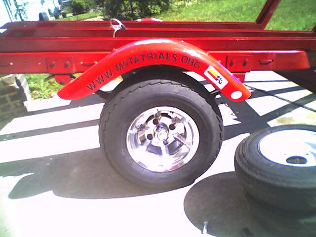

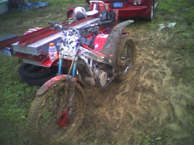

biffsgasgas Posted July 22, 2006 Report Share Posted July 22, 2006 I wanted to do the exact same thing two years ago. Last winter I went to the local auto parts store Pep boys and bought myself 129 dollar special box. Make sure you get the one that fully flips up ie full length box. I removed my center rail and then had to modify the box slightly to fit. It was about an inch too long. With a little finesse from my friend mr hammer she fits fine! I bolted the center rail back down to the top of the box and sealed it up with some silicone. She is water tight. I have towed three bikes on the trialer quite often but i mainly use the center rung for my bicycle and cooler. We went to Oaklahoma (17.5 hours one way) with the miata minder two bikes and a huge cannopy.... Then we did it all over again to tennesse. The box about quadruples the miatas storage room (my ride of choice for long trips). Check it out behind the muddy Montesa. While your at it get some cool rims too. I will go home and get some more pics later. -Biff Quote Link to comment Share on other sites More sharing options...
biffsgasgas Posted July 22, 2006 Report Share Posted July 22, 2006 You can fit a lot of stuff in to this trialer now. All of what you see less the trees and dust. Quote Link to comment Share on other sites More sharing options...
