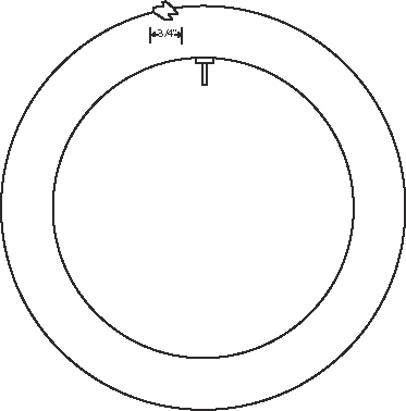

vinnied Posted February 25, 2004 Report Share Posted February 25, 2004 (edited) Any of you Pre65 ers have any problems with rear wheel Punctures and tyre coming of the rim I am approx 15st in gear. New rear tyre plus heavy tube there are two tyre clamps. I was riding on 5lbs approx hoping the 5 would keep the tyre on the rim, not a chance. The tube burst opposite valve. Edited February 25, 2004 by Vinnied Quote Link to comment Share on other sites More sharing options...
bullfrog Posted March 8, 2004 Report Share Posted March 8, 2004 Vinnied: I thought I'd hazard a guess or two which may (or may not) be helpful to you. 1) I'm not sure the location of the tube failure is important in this case. If the valve stem had been torn out - we'd have a good idea what happened. But a tube failure on the OD of the tube near the valve stem? I don't think that tells us anything. 2) Your post said the tube "burst" at that point. Did it burst - or was it "mashed through" - ie stone cut against the rim? Were you riding rocks or other "square edge" obstacles when the tube failed? Does the tire show any signs of abuse = rock/rim cuts? Ed Keep the rubber side down! Quote Link to comment Share on other sites More sharing options...
